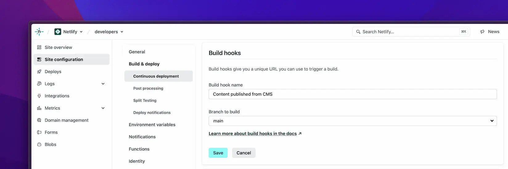

By creating different build hooks, we can initiate new builds from all sorts of different events and see which event triggered our builds. To create a new build hook visit your Site configuration in the Netlify UI and go to Build & deploy to find the Build hooks panel.
You can select the branch that you’d like to deploy and give your new build hook a meaningful name.
Build hook settings

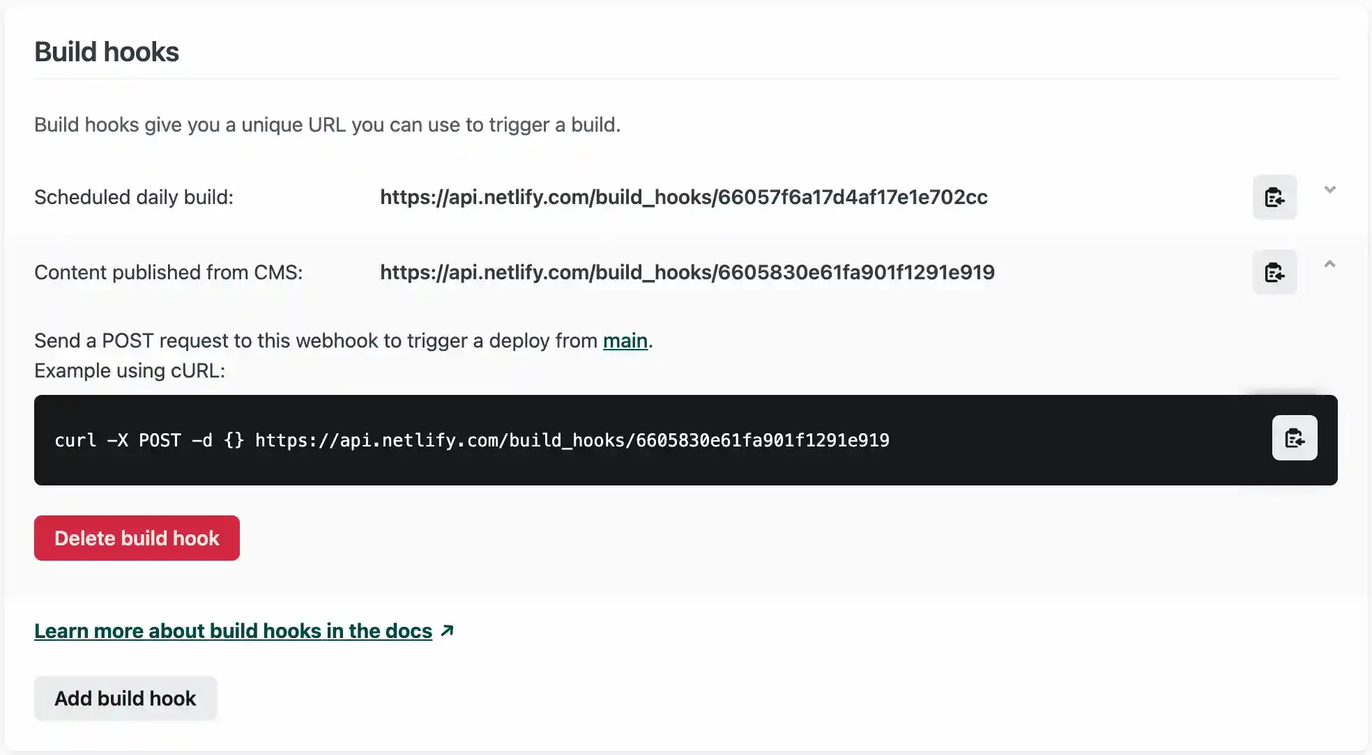

It’s not possible to edit existing build hooks, but the list of your site’s build hooks gives easy access to copy their URLs, and to copy a cURL command to test them out. You can also delete build hooks from here too.
A list of build hooks
