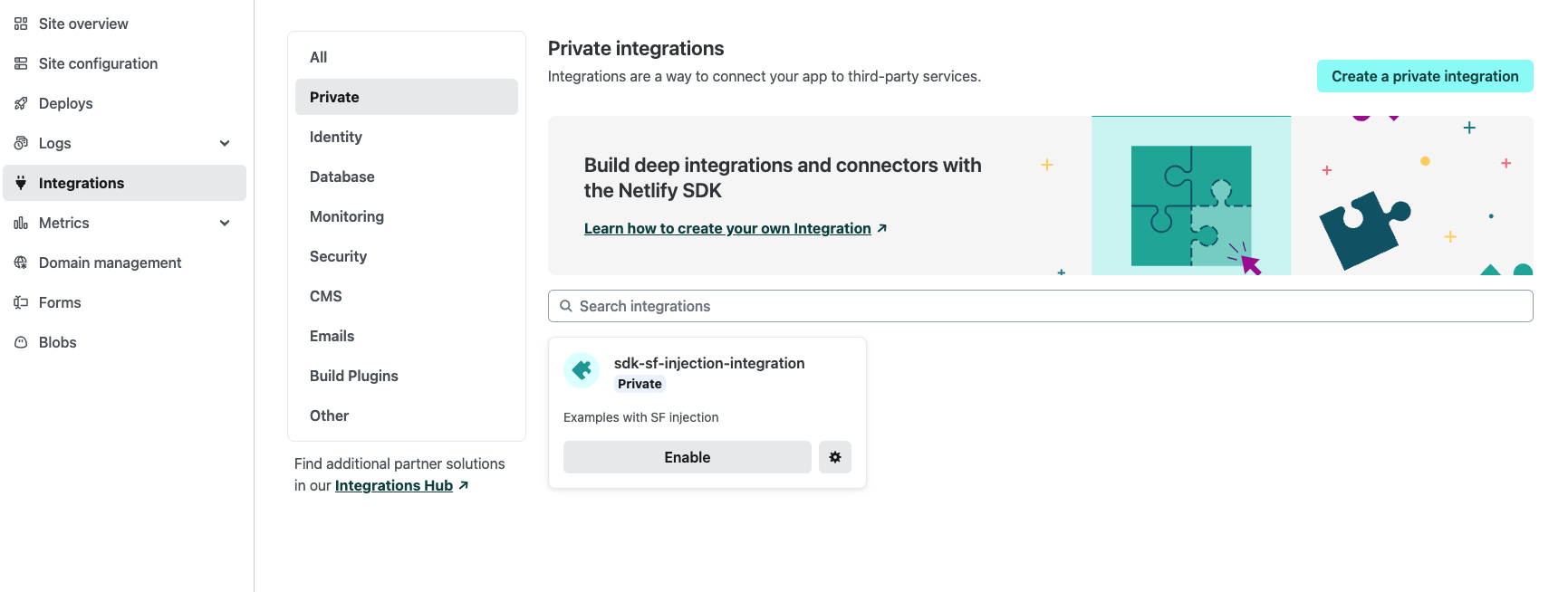

After following that guide, let’s try it out on one of your Netlify sites! You can test it out by finding a site in your Netlify account (make a simple test site if necessary). When you’re in the dashboard of that site, select ‘integrations’ in the site’s sidebar. Then, find your integration in the list of private integrations. The last step is to click ‘enable’ on the integration card.
Enable your integration by selecting 'enable' on the integration card in the Netlify UI
Test it out by redeploying your test site and visiting your site on the /.netlify/functions/sf_prefix_hello-world path. It should say Hello, world!.
