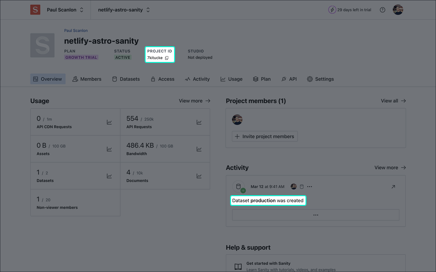

If you now head over to sanity.io/manage you’ll see your new project. Within the project’s settings you’ll find the same projectId and the dataset name as mentioned above.
You’ll need both of these in the next step.

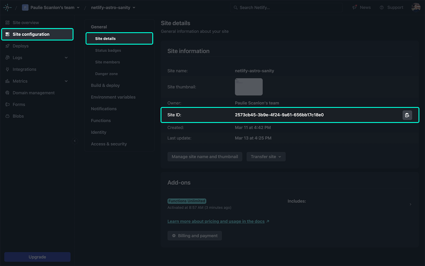

From the prompts in the CLI select > Enter a site id, then head back over to your Netlify site configuration to find your site’s id and enter it in the CLI.
Netlify Site ID in the Netlify UI

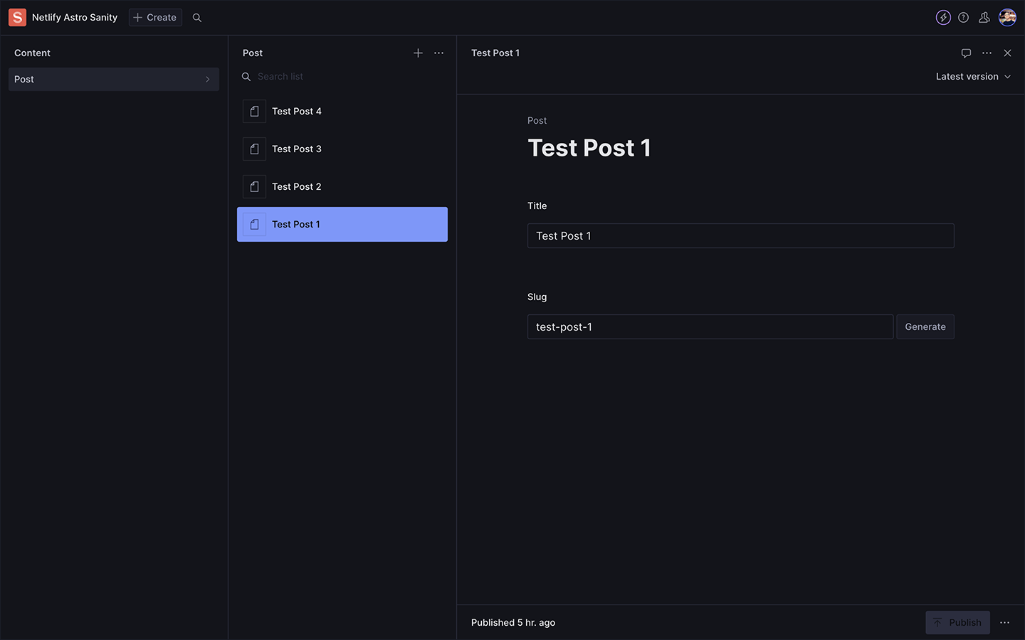

You can go ahead and add a couple of test posts as we’ll need those next.
Sanity CMS UI

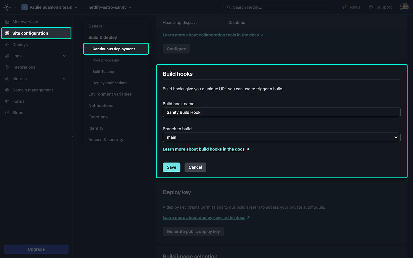

Netlify Build Hook
The first is on the Netlify side. Navigate to Site configuration > Continuous deployment and scroll down until you see Build hooks.
Click “Add build hook”, and give your build hook a name, then select the branch to build from.
If you like, you can read a little more detail about Netlify Build Hooks
In this example we’ve called the build hook Sanity Build Hook and have selected to build from the main branch of our repository.

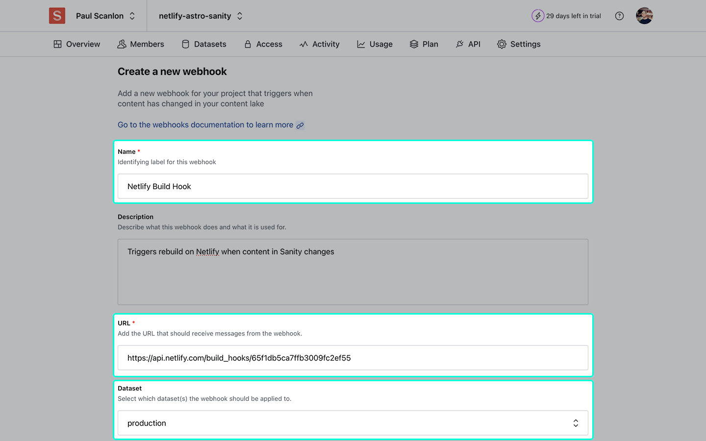

Sanity Webhook
Navigate to API > Webhooks and fill out the fields. Give the webhook a name, then add the URL provided by Netlify. You’ll also need to select a dataset. In this example we’re using the production dataset.
Sanity webhook setup

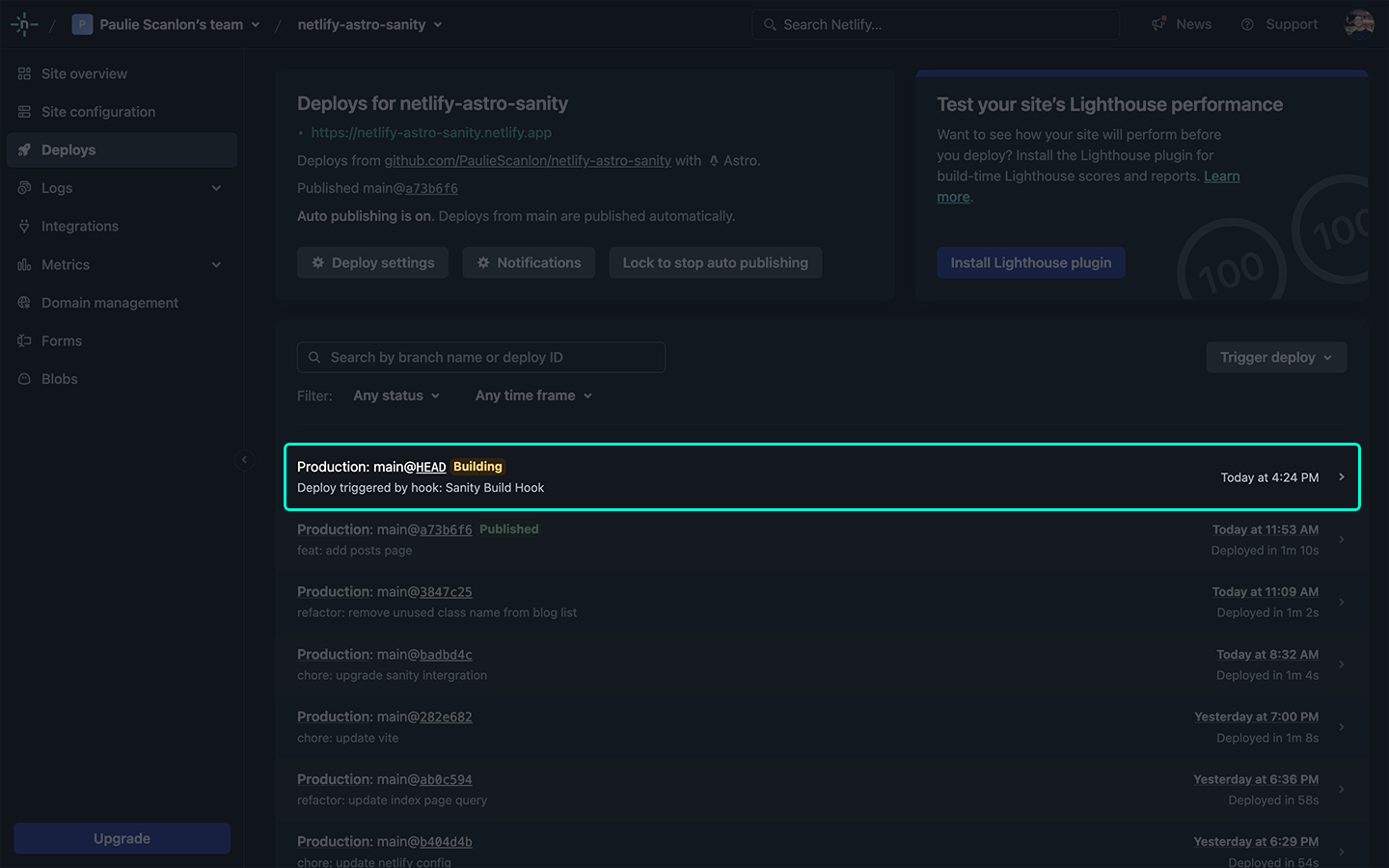

With both sides now set up, go ahead and make a change to the content.
You should notice a new build with the message “Deploy triggered by hook” is now in your Netlify build queue.
Netlify deploy details
