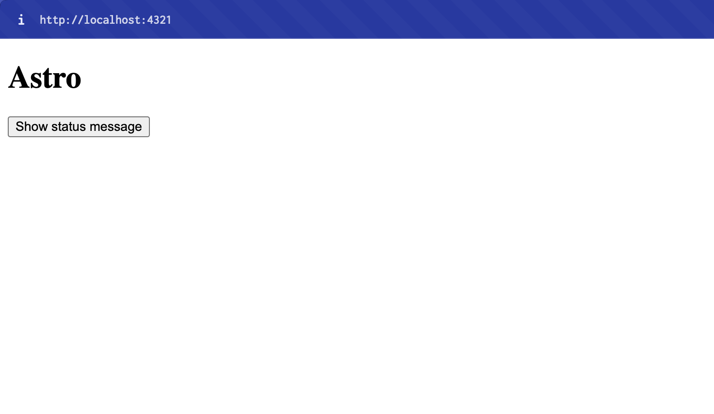

If using the blank starter, your site will now look something like this:

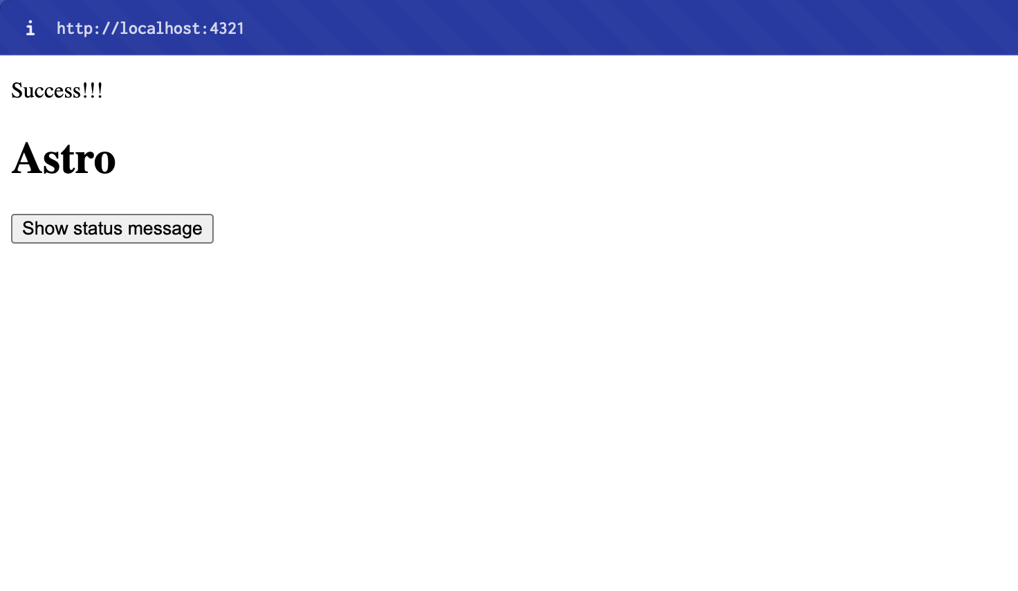

Click the button and you should see your message!

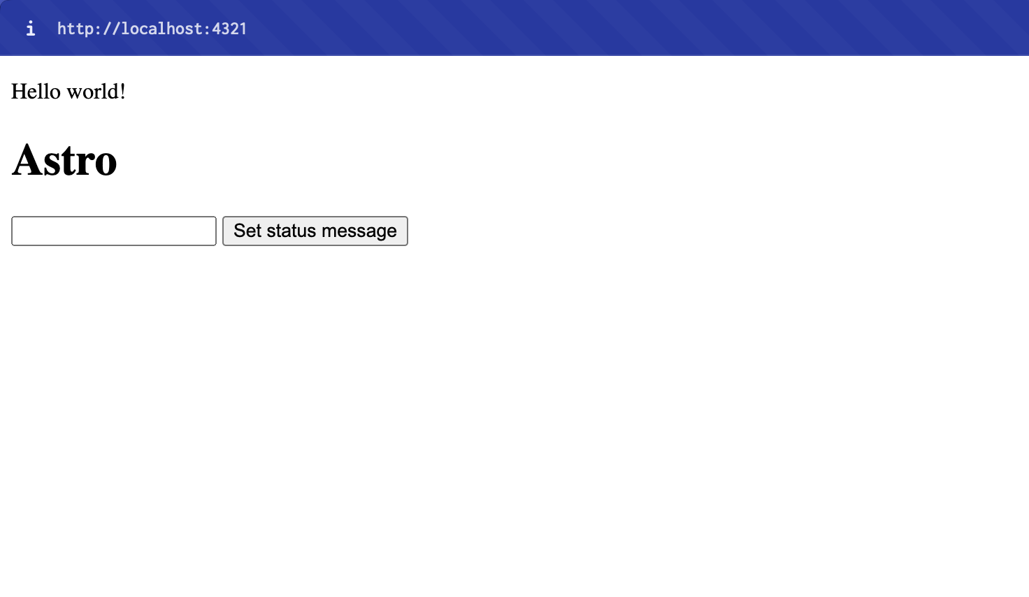

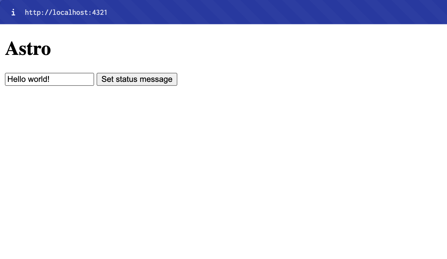

Try it again. Submit the form…
…and the success message appears!
