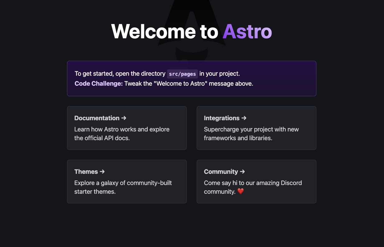

Open your browser to http://localhost:4321 to see your new site.
Astro site running in development
