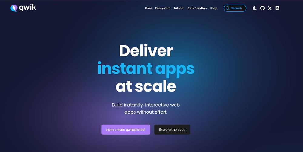

Qwik? Resumability?
Qwik is the first framework that has similar DX (Developer Experience) as React, Vue, or Svelte in how you author components, while delivering Live HTML that is instantly interactive. Qwik achieves this property by completely removing the need for hydration. Instead, Qwik applications immediately execute the event handlers on user interaction, without having to bootstrap all the app state. This technique is called Resumability. — Qwik
